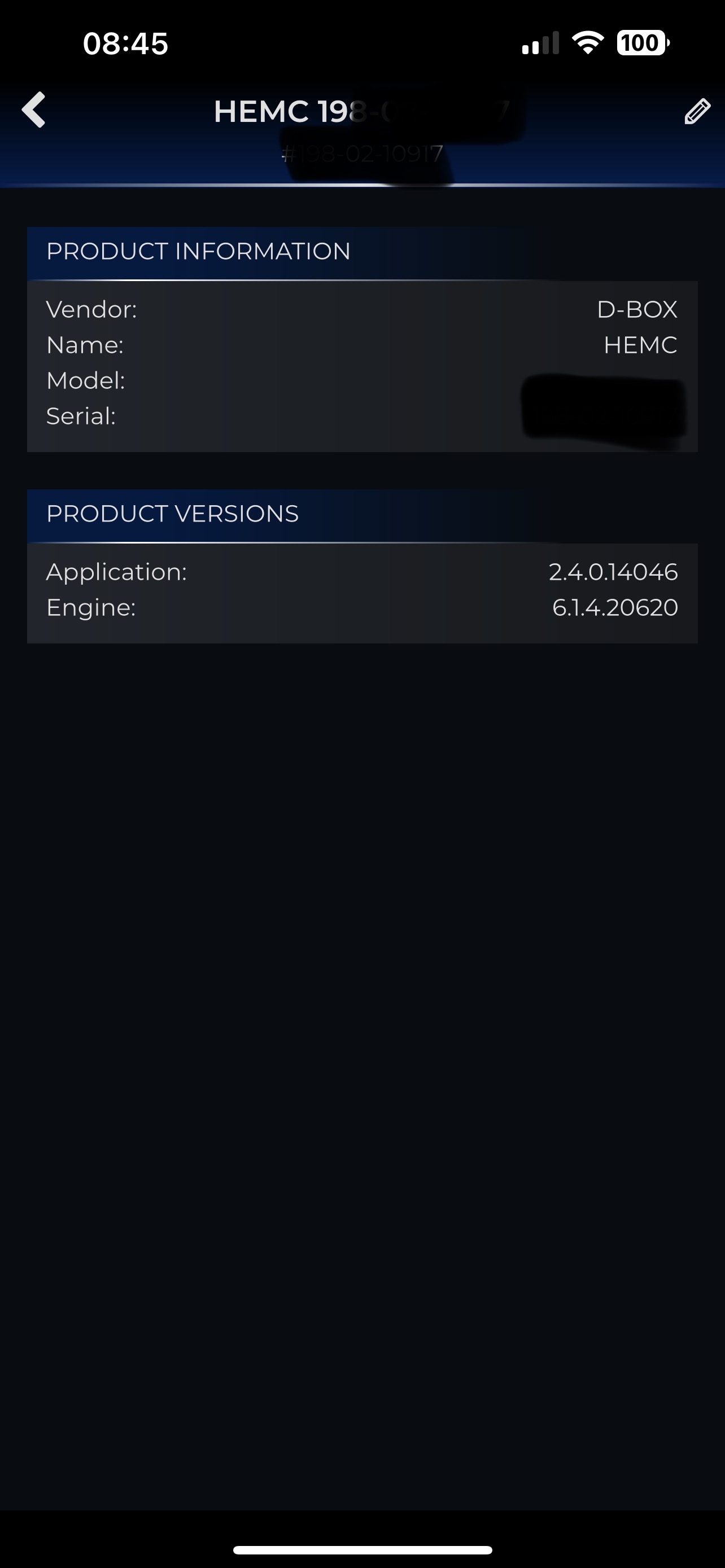

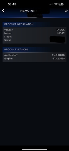

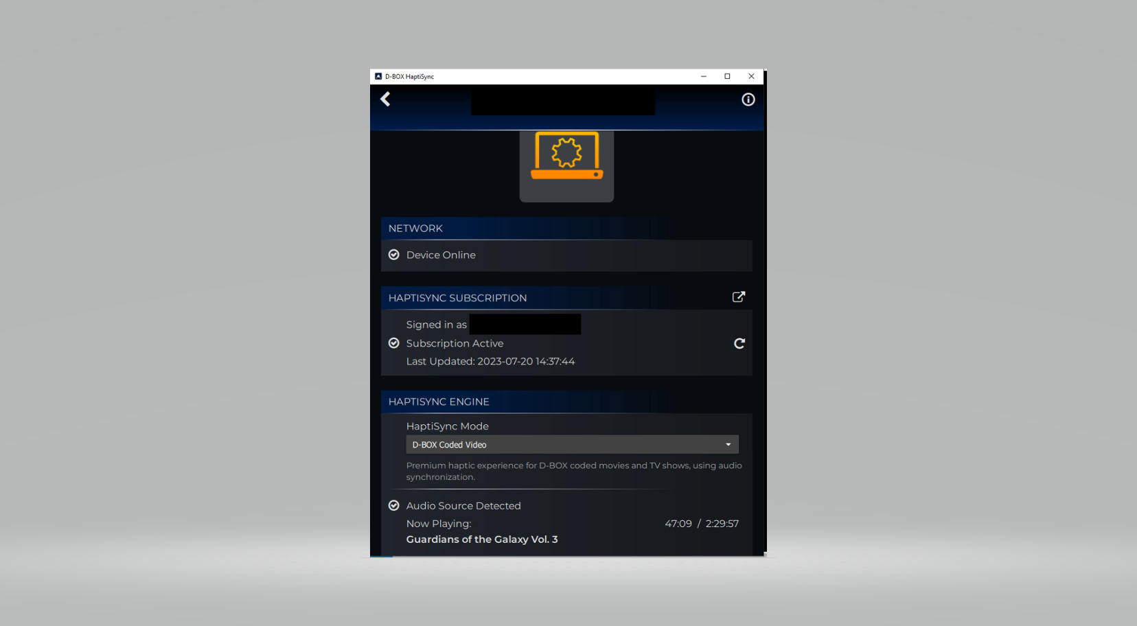

We tested the movie Guardians of the Galaxy Vol. 3 on our in-office devices (HapticSync Hub, HEMC and Windows PC) and have not found any issues thus far. Please let me know if you are still experiencing the same issue. Some screenshots of your settings on the HapticSync App would be greatly appreciated.

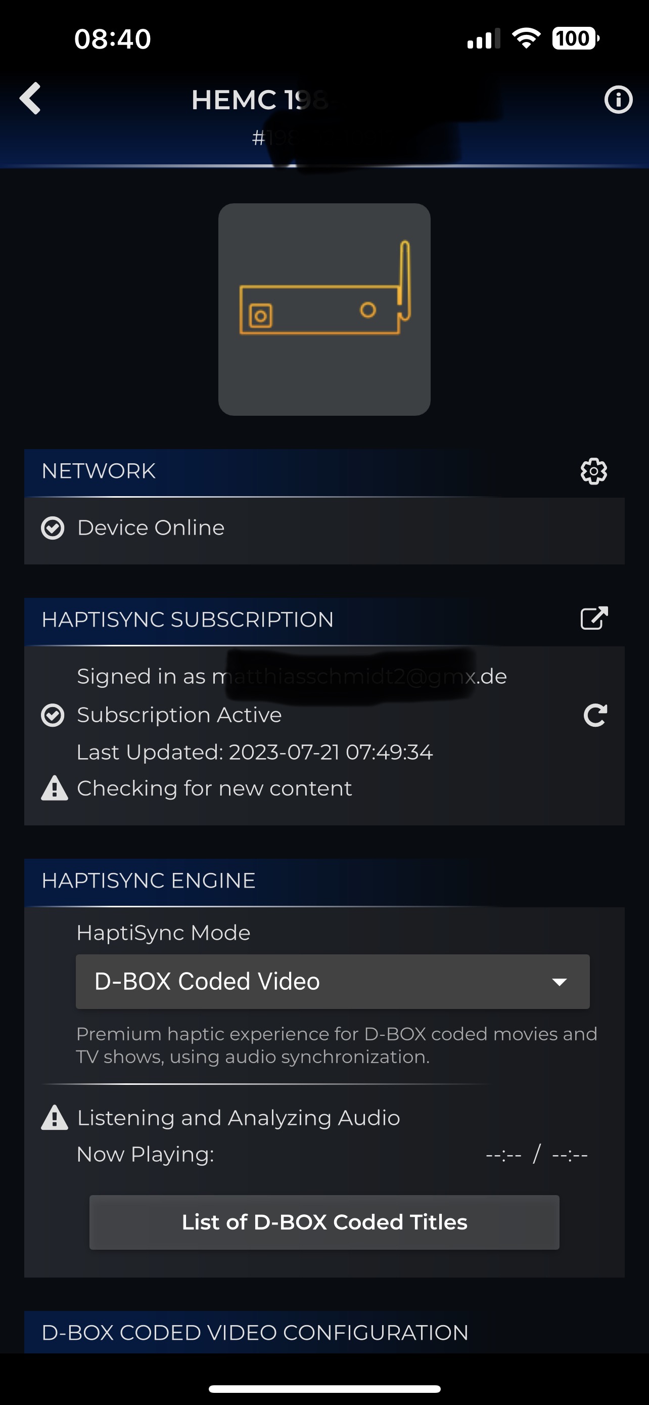

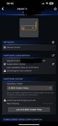

Hi! Thanks for your Feedback, but it’s still Not Working. Also my a collegue have the same Problem. All other movies working:
My HEMC is Online, if you want to Check.
Now the movie is recognized by the HEMC , but the seats are Not moving… seems to be something is broken with the Code….

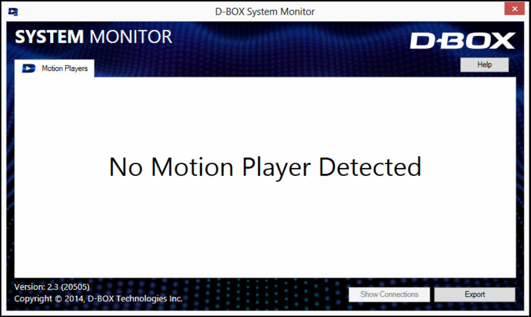

Please let me know if your seats are powered because on the System Monitor, none of your seats are showing.
